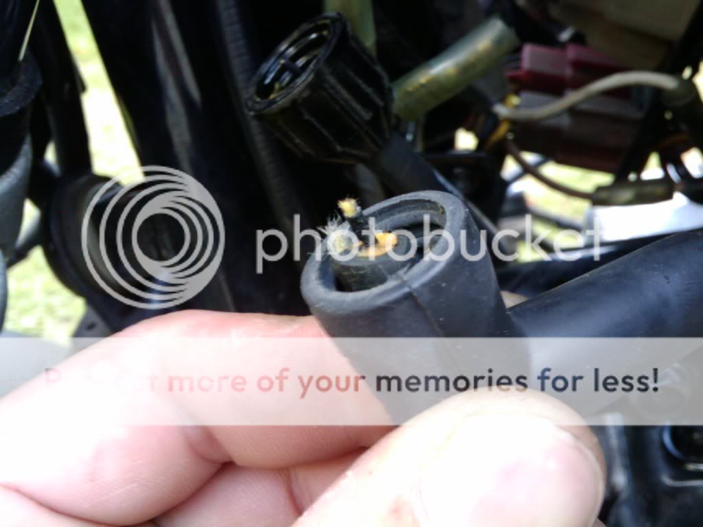

Also the bike has alittle miss sometimes. So I pulled the plugs cleaned them up (were not bad) then was checking the plug wires and found this
This is where the plug wire goes into the coil. It looks like the end is missing, or is that how it should look?
