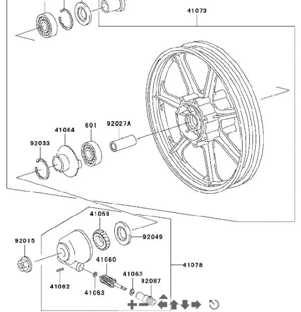

Still working on the tach but got to drive it yesterday and the speedometer wasn't working. Pulled the cable loose from the front wheel and spun the cable with my drill to see if the gauge worked....it did. Could the sensor on the front wheel be bad? I did notice the cable just slips into the sensor into a slot. Can the cable slid back of the slot and not spin?

Check to see the condition of your drive gear that runs the spedometer gear. I had two of these go bad. The corners that go into the spedo gear should be nice & square. If they're not, it can slip.
Part 41064

Think the gears are bad. Gonna try to find another unit and thanks for the digrams kanuck. Helped alot.
