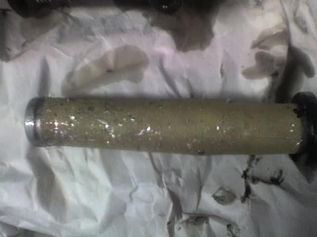

Any "strange" noises when the engine is running?? The reason I ask is mine had a small leak in the same area that wouldn't seal up and a grinding noise when it ran, other than that it was (finally) running fine. I got readyto do an engine pull so I drained the oil to find this on the filter screen:
Pulled the engine removed the crankcase cover to replace the gasket and opened it up to find this:
The dampners that had been in there had broken down to this:
and allowed the bolt holding the balancer and the balancer gear together to fall out (left-handed thread by the way).
The gear still rolled but would drop onto the crankcase chewing the ****ins out of the inside. I am in the process of repairing this little gem now.
Good luck, hope things are much better for you and it is just a gasket!!

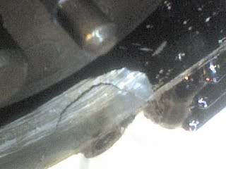

Question found large or rather long crack in casing.
Bullwinkle,i do belive you are right!.
crack is right at bolt sight,have marked it.Now as to what should i do from
here?,is it worth fixing or not-that is the question?.
So what kind of a job are we talking here.amature or pro?
is it worth redoing,or better to part it out.
All sugestions are welcome.
CableRat
