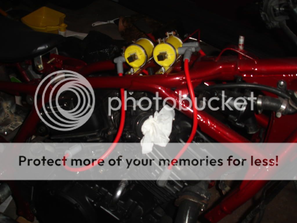

Our plug ends have a resistor in them, that is why they are built the way they are. That is probally why they are not working. you can get aftermarket on ebay, or just throw some accel coils on like I did.

post #5 of 17 (permalink) Old 05-14-2011, 10:47 PM
Join Date: Mar 2010
Location: jacksonville, fl
Posts: 335
this is my coil set up
