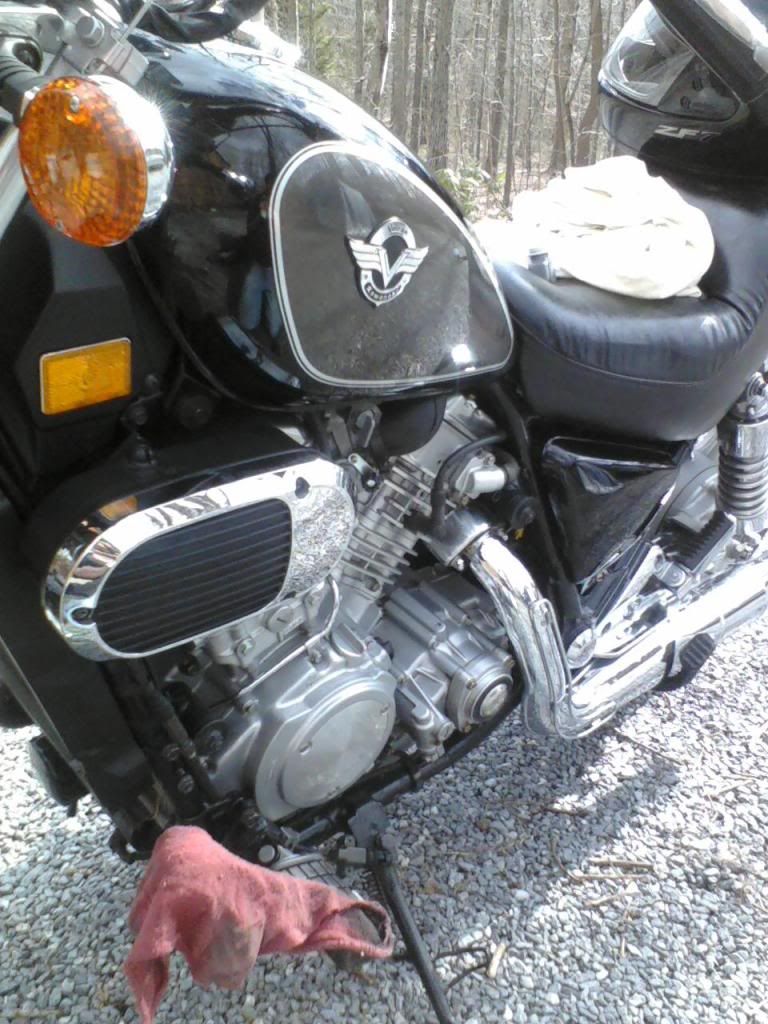

Sunny day!
Just waxed the tank, and polished all the chrome parts!
