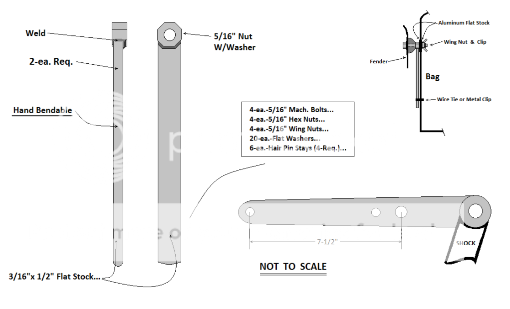

Well, I'm doing some ridgid mounts that I am planning on making removable...
The bags are Vikings (I think they will be here today) and supposedly have a hard back that has a shock cut out... I made myself up a sketch just to keep my mind streight (I sometimes have CRS)...
here it is if you can understand what I have in mind...
If you need to go outside the shock you would have strut them out...
Upper left corner you can see in a smaller scale the fender strut and fender and bag using the legged nuts with wire ties to keep from flopping...
The clip (hitch pin clip) removes and the wing nut for removal...
Note also, although the back of the bag is supposed to be ridgid I have a piece of aluminun on both sides...
The hitch pin clip is because I ride Sportster and need to keep the wing nut from viberating off...lol... I beat you to it...lol...
post #4 of 8 (permalink) Old 01-12-2011, 04:30 PM
My post above is just to help you think your bike and bags out as about all are different, I just didn't want to pay the +/- $150 for the "Easy Brackets" or the same for "Ghost Brackets"...
PS-I can't remember what or how the fender struts were made on my VN750, but to strut out past the shocks you might use a piece of thin wall square tubing...
