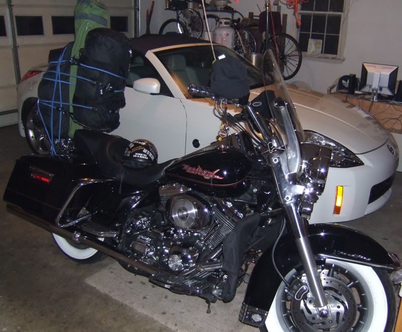

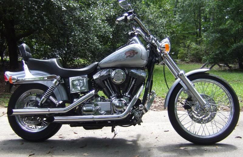

Here's a pic of my current ride, and I hope it gets some garage time with the Vulcan 750.
Some past one's also... I miss these bikes!
I built this one to be a really nice HP/TQ monster.
My Road King loaded up and ready to ride to Bike Week in Daytona.
