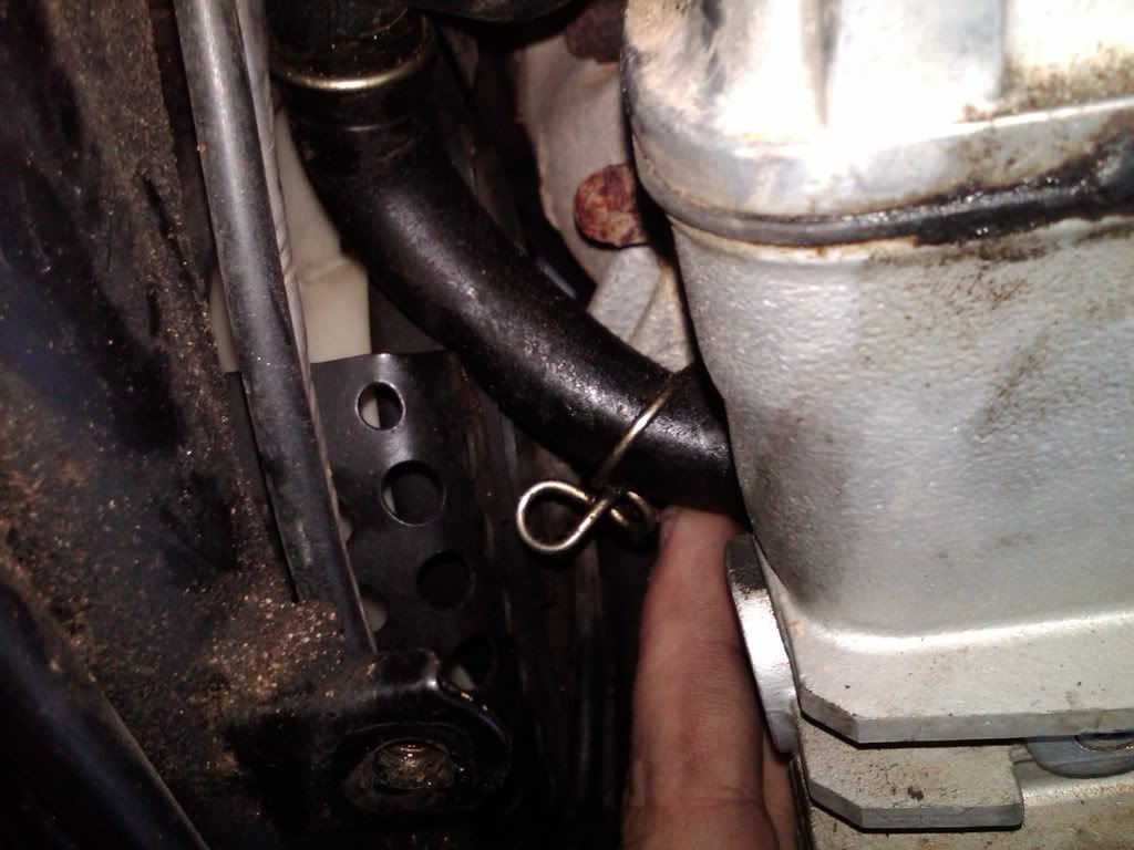

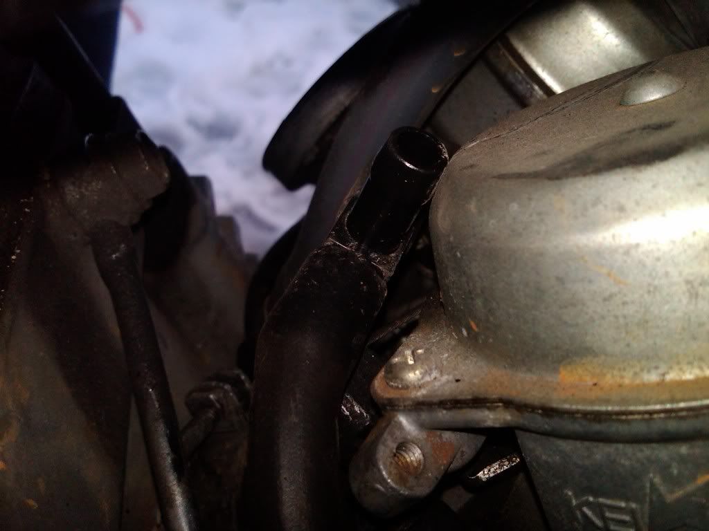

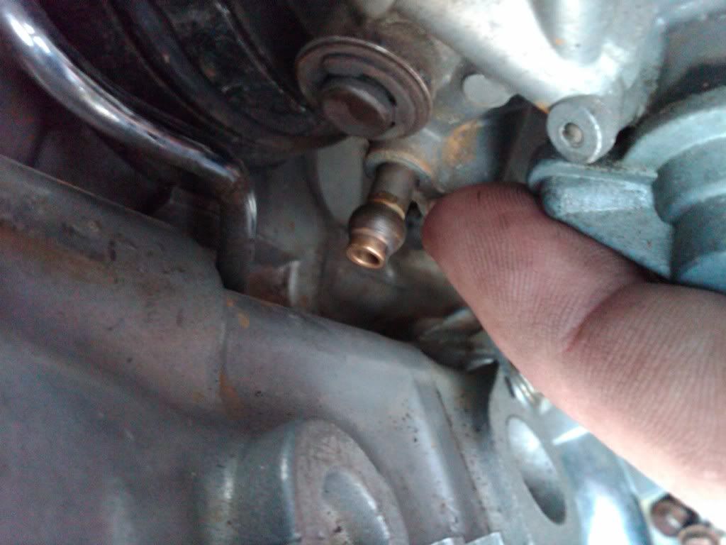

To make sure I am referring to the correct parts I took pictures.
I am going to cap this off, correct?
This I can get a longer hose and attach a filter on the end correct?
This has one end connected to the air box but I am not sure where the other end went. Does this simply get removed?

In the first picture, if that fitting is on the right side of the rear carb, yes, you cap that off.
In the second picture, if that is the crankcase vent hose, then yes, replace it with a longer one, with a filter on it, and stick it in any convenient place.
In the third picture, that is the airbox drain hose. It gets tossed along with the airbox.

Yes the first picture is that of the right rear carb, I will go out and get a cap for that. The second picture is of the front cylinder and is facing the front of the bike. You can see the radiator fan in the pic.

Ok, then you lucked out, and do not have a CA model. The one hose going to the tank is the tank vent, and the other end just needs to be left open. The hose in the second picture, which is also visible from the other side in the third picture, is the crankcase vent hose. If you are removing the airbox, you will need to keep this hose attached to the engine, or else replace it with another hose attached to the engine, and put a filter on the end of it. The filter can be located anywhere it can get air.
