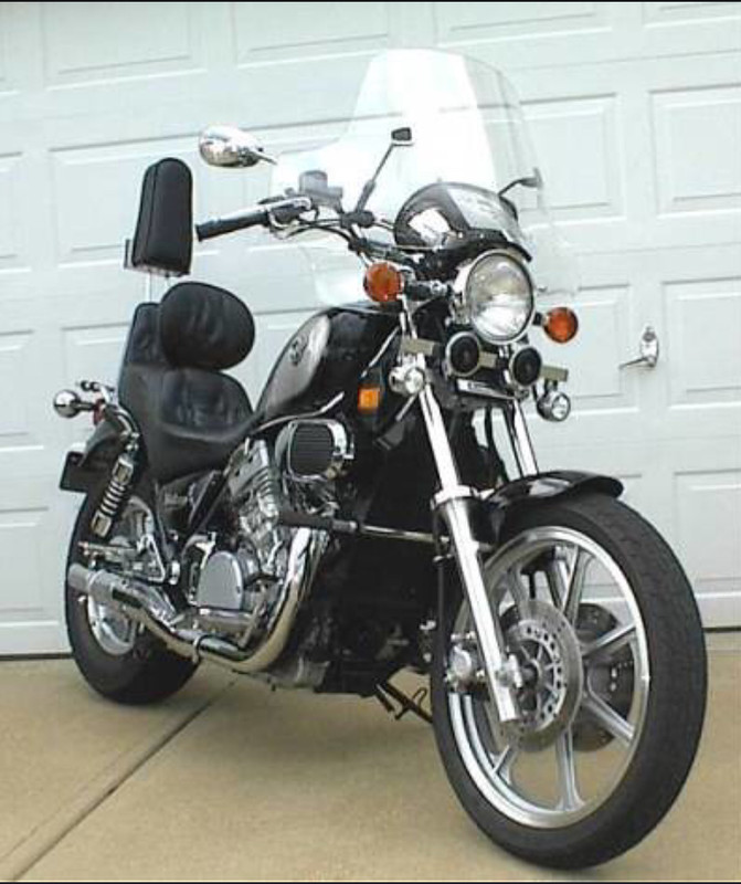

I had the Plexistar 2 windscreen, which looks like they no longer make, basically a Plexifairing without the “lowers”. Hand-guards on it fit better. Photo of it below...
Did a good job keeping me out of the wind, but not as good as a full fairing like the Vetter type.
A pair of good insulated motorcycle pants, jacket and gloves and no problems riding at those temperatures.
