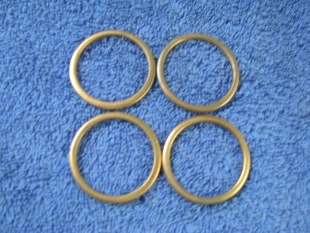

1) Do the gaskets need replaced every time they're removed? Or have you been able to reuse them at least once?
Read here that there's a flat side that faces the engine...
2) Do they crush when tightened down? Also read about the Harley gaskets being better than Kawi.
Trying to decide if I should order some or wait and see if I need them first.
3) Do these look like the correct gasket? The ad says they fit a large number of engines, from 70s 2-strokes up to late model tourers.

1)Everyone I have ever spoken to has said you need to change them when you remove them. So that's what I have always done.
2) Harleys gaskets and clamps seem to me to be more robust then our Kawi's do. I have switched over to them.
3) and you can get the oem ones from
http://www.kawasakipartshouse.com/oe...27fd/muffler-s
Part number 11060 5 bucks each

Those in the pic are $10 for four, but I haven't taken mine off yet, so I don't know what they look like.
If they don't crush, seems like they should be good for a couple of rounds.

they are called crush washers because thats what they do is crush down to fill the imperfections and make an air tight seal fo there is no exhaust leak so yes they are supposed to be replaced every time
however i have had my same pipes of a few times and havent replaced them yet i did get new ones when i ordered my vance and hines pipes though

Do those in the pic look like the new ones you have?

I had my exhaust off and re-used the ones I got, did not seem to leak or sound funny - so i am going to stick with it.

yeah they are the right shape lol

Id still replace them if I were you.. If you interested,, I believe this is the Harley part number
17048-98
Cheapest I found the OEM's btw 4.38
http://www.partzilla.com/parts/detai...FUZV4AodhxYAKw

This is a clearer view of the gasket. If you notice, it has a definite ridge on one side. I couldn't tell if the ones you displayed have this ridge or not.

These are the Harley gaskets I use...for Evos...Ive taken on/off countless times...
http://www.ebay.com/itm/200856263369...f75ac9&vxp=mtr
http://www.americansportbike.com/sho...show/5931.html
I get em for $3.50 each...tapered side towards pipe...
